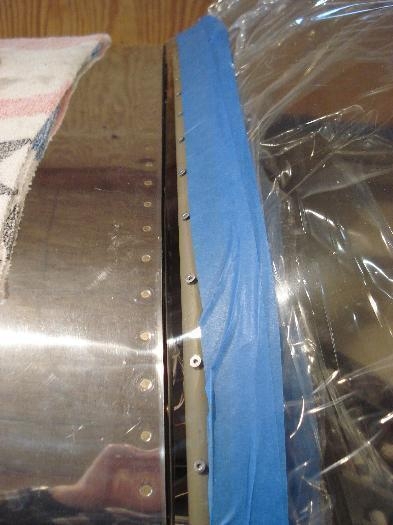

Went to the airport but did ground session only - too windy to fly with a new student, as usual. Got to the shop about 11 AM. Installed the latch mechanism, and fabricated the guide blocks while the shop warmed up. Then riveted the front of the canopy along the front bow. A few rivets are a little high, but the book says that is preferable to setting them too deep.

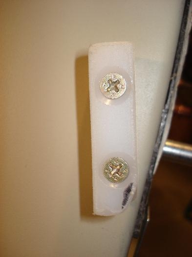

After lunch Carolyn came up to the shop with me and so I could work inside the plane and she could be the tool gopher and my safety pilot in case I somehow trapped my self in there. Right away we ran into a problem when I installed my carefully crafted guide blocks, and they proceeded to catch on the most aft side nut along the skirt. I overdid it on removing material, and effectively ruined the blocks. A bigger problem surfaced - the canopy wouldn't go all the way down on the left side where the side skirts have to overlap the side skins. Something changed a bit since screwing and riveting the canopy to the frame.

Canopy front riveted.

I screwed up the guide block.
