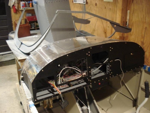

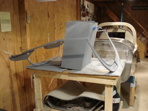

Brief Description:  Prepped and primed canopy frame.
Re-installed the skin over the instrument compartment. Installed the canopy frame, cardboard strips, and spacer blocks. Bent the forward tube slightly to standardize spacing to the panel. Not perfect, but the best I can do. Fluted to shape and match drilled attach angles to frame. Removed frame and deburred all parts. Started up the exhaust fan and primed the frame, other parts, and the fuel tank.
Forward skin back on.
Canopy frame and tank primed.
