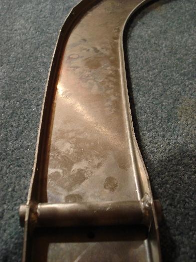

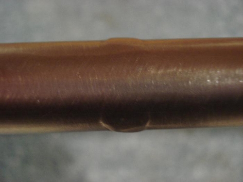

Used the die grinder with coarse ScotchBrite disks to grind down the weld in the canopy bow where the plexiglass bubble will contact it. Smoothed the weld somewhat the rest of the circumference just to improve appearance. Not sure how much it will show in the finished product anyway. Deburred the rough edges on the AL plates at the forward end of the frame. Used a flat file and the die grinder. The aft frame edges are very rough. Not sure how much they will show, but I think they need to smoothed out. Will check Marty's blog to see what he did here.

Canopy frame bow weld smoothed.
Aft canopy frame rough edges.
