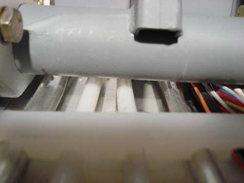

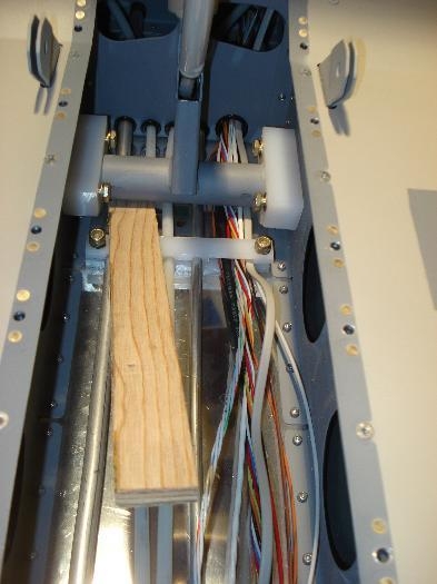

Next installed the flap handle. Determined that the bottom of it was in contact with both fuel lines, as previously reported by other builders. Sanded the end of a strip of plywood into a thin wedge, and tapped it between the fuel lines and the bottom of the flap handle until the fuel lines were bent downward, away from interference by the handle mechanism. Fuel lines flattened a bit on the top sides but did not suffer significant deformation. There is now enough clearance to prevent rubbing when the flap handle is moved.

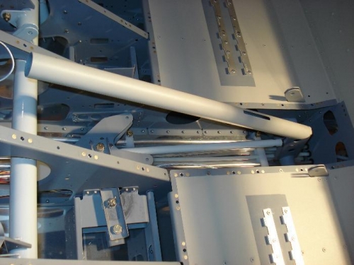

Installed the parts that make the connection to the flaperon mixer arms and fabricated the control stick pushrods.
Flap handle.
Flap handle.
Bending the fuel lines down.
Fuel line clearance.
