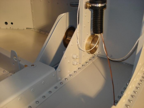

Went back to wiring in Section 31. Hooked up the FT-60 and the fuel pump. Ran into a snag on Page 31-04. There appears to be a hole missing on each side where the spar pin wiring goes. Emailed support with pictures.
I think there should be a hole here.
Page 31-06 Figure 5.
