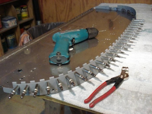

Brief Description:  Built the upper firewall.

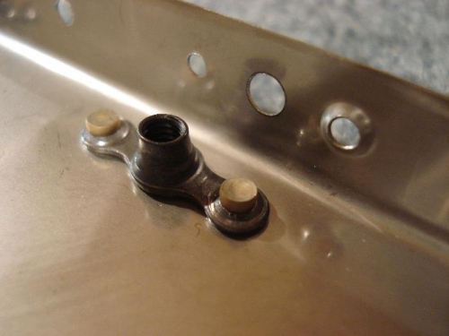

Wow! Page 29-02 is busy place! Can't believe it took me all day to complete one page. A lot of fabrication tasks and deburring. A zillion nutplates to dimple, countersink, rivet, etc. All went well until the very last step, which is to dimple the holes in the flange. Trouble is, one of the nutplates installed in Step 6 is in the way. Seems like the sequence is wrong. I will either have to drill out the nutplate or just countersink the rivet hole instaed of dimpling it.
An awful lot of nutplates and rivets!

Oops!
Oops!
