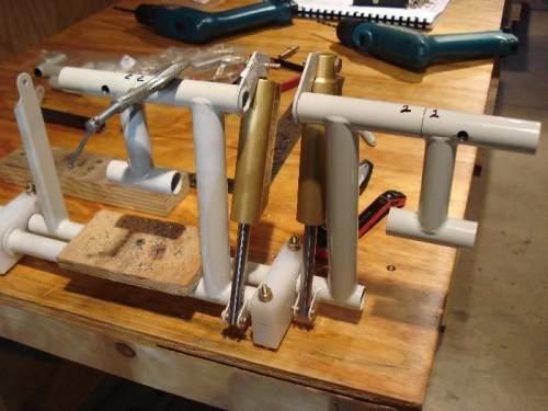

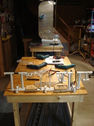

Began work on the rudder/brake pedal section. Found it necessary to clamp the assembly down to the flat surface with a couple pieces of plywood and long screws. That way they can't move during the drilling. Used a square to assure vertical position of the brake pedals. Drilled the first two as instructed.
Next - drill the other two and proceed with the tubing.
Rudder pedals clamped to bench.
Brake pedals clamped for drilling.
