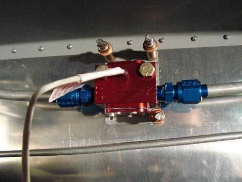

Brief Description:  Finished fuel system.

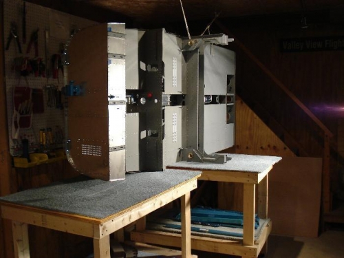

Sent Gus an email asking him to send the mini nutplates and 17A bolts that were not shipped with the fuselage kit. Temporarily mounted the FT-60 sensor to facilitate fabricating and installing the pllumbing. Reworked the bulkhead to tank return line and clamped it to the supply side line. Worked out OK. I just hope there is enough slack in the tubing to hook up to the fuel tank when the time comes.
Made up the remaining supply-side pipes from 3/8" stock. That went pretty well and everything is hooked up. Torqued all the tubing fittings using the fish scale I bought this morning at WalMart.. Well, actually, not all the fittings. Left the two pipes either side of the fuel flow sensor finger tight to ease the permanent mounting of the sensor when the missing parts come in the mail.

Fuel flow sensor temporarily mounted & plumbed.
Fuselage on side for plumbing.
