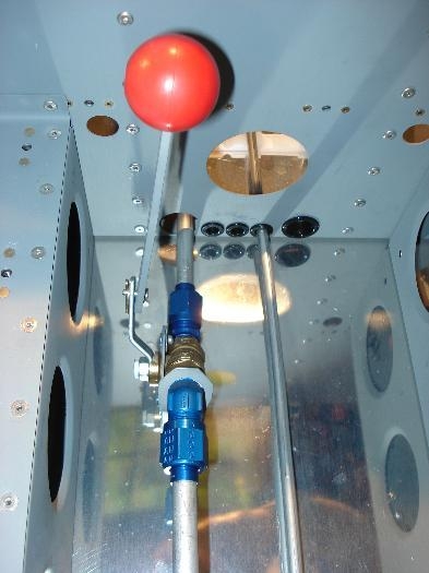

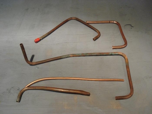

Assembled and mounted fuel valve. Practiced making bends in 3/8 tubing using the old oil tank scrap. Made up the tank-to-pump pipe with no real problems. Corners are not perfectly square but the gas flowing through won't know the difference. Made up the pump-to-valve piece and installed OK. Began work on the valve to flow sensor section, and that's where the day began to go down hill. The previously installed mounting bracket for the flow sensor was set up for the wrong sensor. The plans were for one sensor, but the other sensor was sent with the kit. Got Carolyn to help me roll the fuselage up on the side so I could drill out the rivets holding the bracket to the bottom skin. Removed the bracket, but could find no correct size 1/4" nutplates. Called tech support later, and Gus says there should be some of the right size here somewhere. I'll look tomorrow. Also need to pick up some AD4-17A bolts to mount the sensor, since these didn't come in the kit either.

Practice bends with scrap.
Fuel shutoff assembled & mounted.
