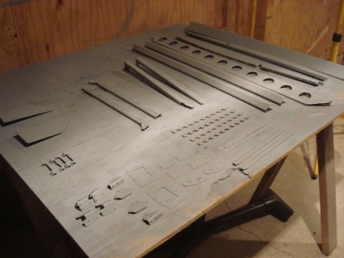

Date:  9-29-2009
Number of Hours:  3.00
Manual Reference:  23
Brief Description:  Finished prepping all Section 23 parts and stored.
Finished deburring miscellaneous Section 23 parts. Removed longerons from the clecoed frame and tweaked the tails one more time, then put in storage. Removed the side skins and stored. Disassembled all the side frame members. Roughed up, cleaned, and primed all Section 23 parts except for skins and longerons.
Thought about the most efficient (hopefullly) build sequence for the rest of the fuselage kit. Came up with the following. Strategy is to do as much interior work as possible before putting on the sides, and postppone installing the tail section as long as possible for space considerations.
Section 28 - Fuel System
Section 27 - Rudder Pedals & Brake System - Finish but do not install yet
Section 26 - Seat Backs - Build but do not install yet
Paint completed portion of Interior - paint remaining parts as they are installed
Section 23 - Side Skins - Paint & install pre-prepped frame parts, prep/paint/install sides
Section 24 - Rollover Structure & F-1207 Bulkhead
Section 29 - Forward Upper Fuselage
Finish Kit - Do what can be done before tail install
Section 25 - Tail Cone Attachment
Section 23 parts prepped and primed.
