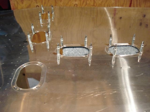

Date:  7-5-2009
Number of Hours:  3.00
Manual Reference:  21-16
Brief Description:  Worked on bottom skin.
Finished deburring and primed the bottom skin doublers and stiffeners. Deburred all the edges and openings in the bottom skin, and began installing the nutplates in the five instection ports. Found it tricky to use the rivet squeezer because the 3" yoke is actually too long for the opening. Solved the problem by using my ground-off flat die.
Bottom skin almost ready.
Access hole nutplate install.
