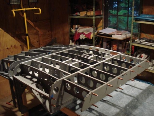

Another rainy day. Bad for flying airplanes, good for building airplanes. Worked in the office this morning, hit the shop about noon. Prepped the seat ramp floors, the step ribs and bulkhead, and primed. Installed the seat ramp floors. During the process dicovered I had installed nutplates on the wrong rib flange the other day, removed those and installed in correct place. No biggy.
Installed the step ribs and bulkhead. Neighbor Dave helped me reconfigure the work tables and flip the assembly. Looks different upside down. Installed the snap bushings as specified - I think! I found the drawing very busy and had a hard time getting the perspective. Tonight I am going to color code the diagram and tomorrow I will triple check the placement of all the bushings.

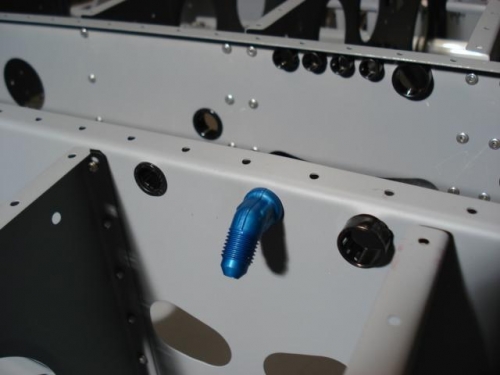

Then I installed the bulkhead fuel fitting early as suggested by Joe Gores. I found the diagram on page 28-06 to be VERY confusing but I think I figured it out and installed the fitting in the right place.
Assembly turned over.
Fuel fitting - early install.
