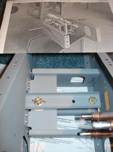

Tony T. saved my bacon big time! He noticed I had installed the flaperon mixer arms backwards from the pictures on my Kitlog, and emailed me from Seattle. Since I had not yet riveted the seat floor to the assembly it was easy to unbolt the two bolts and reverse the arms. Boy would that have been a mess if it had been all sealed up. Thanks Tony!

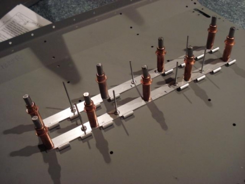

After re-assembly I finished up riveting the seat understructures, and then prepped the seat floors and seat floor supports. Then fabricated the seat back hinges and started to attach them to the seat floors.

Flaperon Mixer Arm Assembly improperly assembled.
Flaperon Mixer Arm Assembly properly re-assembled.
Seat back hinges ready to rivet.
