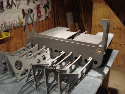

Date:  6-20-2009
Number of Hours:  7.00
Manual Reference:  21-06
Brief Description:  Worked on seat frames.
Bad news - yet another rainy day. Good news - spent the day working on the project. In the morning I Scotchbrited, cleaned, and primed all the seat ribs and parts for the seatbelt attach points. Had to spray primer in the shop where it was warm and sort of dry. Aired it out after lunch and began assembling seat under-structures. This area requires installing a LOT of nutplates and I must have changed dies in the squeezer 50 times. Seriously thinking about ordering one of those dimplers mounted on a visegrip. This was a fun afternoon because I got to actually build some sub-assemblies rather than just deburr and deburr and deburr! Next I set aside these assemblies and start working on seatback hinges and seat floors.
A good day's work.
