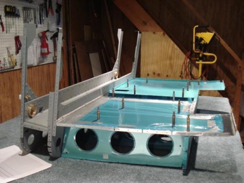

Brief Description:  Completed Section 20 except for final riveting.
Put the first light squeeze on all the long AD4 rivets with two flat dies just to hold them in place. Going to call Avery Tools tomorrow to see what they recommend as far as squeezing these rivets to spec. May order short version of the cupped die. Or alternatively, just final set them with the flats.
Completed the rest of the steps in Section 20. Retrieved all the parts and pieces for Page 21-02. Clecoed the baggage floor and underlying ribs together just so I could visualize the assembly. Have a day off from flying tomorrow so hope to get all the parts prepped - dimpled, deburred, and primed.
Baggage floor dry run.
