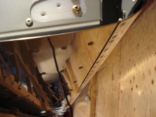

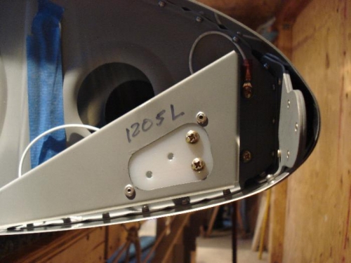

Brief Description:  Fitted and installed wing walk doubler.
In AM worked on getting a bend in the wing walk doubler curved edge using several suggestions from my VAF query. Ended up clamping the piece between two wood strips on the edge of the workbench, and tapping the edge over with a hardwood block. Worked good and I got a perfect fit. Primed top of wing skin and bottom of doubler. In late PM installed doubler and partially riveted.
Doubler fit on leading edge bottom.
Doubler fit, at end.
