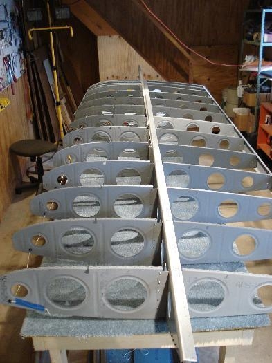

Brief Description:  Finished skeleton, started skins.

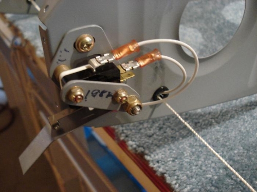

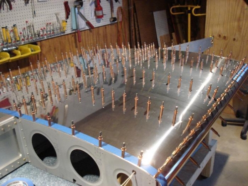

I think this was the first time I put in a full day on the project. Installed all nose ribs. Tricky riveting on the inboard ribs due to closeness of flanges. Used the little wedge tool a lot, and the manual puller. Fabricated the wiring and installed the stall warning switch. Temporarily installed mid wing skin to adjust switch. Removed blue vinyl, deburred and installed the first wing skin. Everything lined up perfectly and it's ready to rivet. Didn't feel like getting into riveting late in the day so began prep of outboard skin. Pulled vinyl and enlarged tiedown hole to 3/8 using the step drill.

Wing skeleton completed.
Stall warning mechanism mounted in wing.
Inboard bottom skin ready to rivet.
