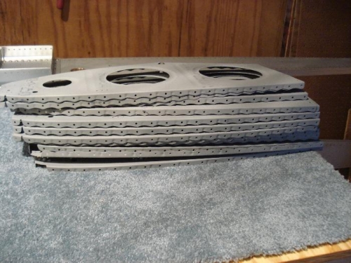

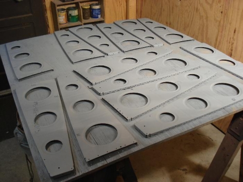

Brief Description:  Completed left wing rib preparation.
Deburred small openings using emory boards and both Scotchbrite wheels where possible. Removed labels and used Scotchbrite pads to polish out scratches in webs and rough up entire surface. Cleaned with solvent and primed. Picked up tools and cleaned up the shop. Ready for visitors tomorrow to help assemble left wing skeleton.
Left wing forward ribs.
Left wing aft ribs.
Left wing aft ribs.
