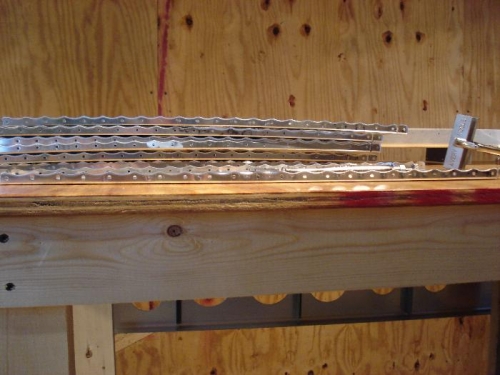

Brief Description:  Finished scalloped edge deburring, fluted.

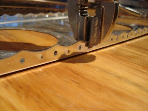

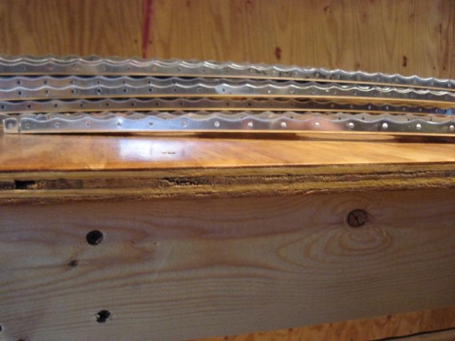

No, I didn't take up a musical instrument. Fluting is the process of crimping the rib flanges to straighten them. When the ribs are stamped out of the aluminum stock they usually come out with a bend. Notice how the rib in Image 1 is bowed up away from the table top. After fluting with the special tool the rib lays flat (Image 3.)

Before
Before
During
During
After
After
