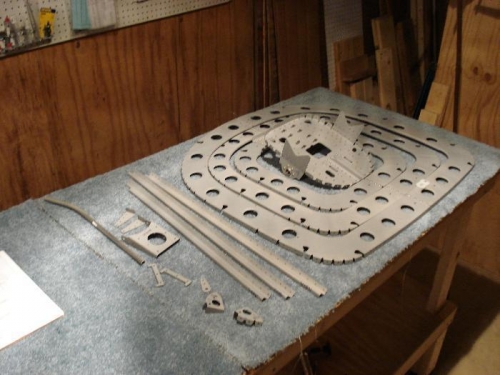

Date:  1-29-2009
Number of Hours:  3.00
Manual Reference:  10-02
Brief Description:  Finished tailcone skeleton parts.
Corrected high rivet problem from yesterday by replacing one, polishing heads of others. Re-primed the area affected. Finished deburring fuselage frames and other small parts. Primed and assembled per plans.
Inspected the tailcone bulkhead for quality. Looks good but the AD4 rivets aren't quite squeezed to specs - I will give them another squeeze tomorrow. Yeah, I know, picky picky picky.
