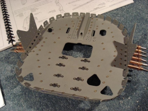

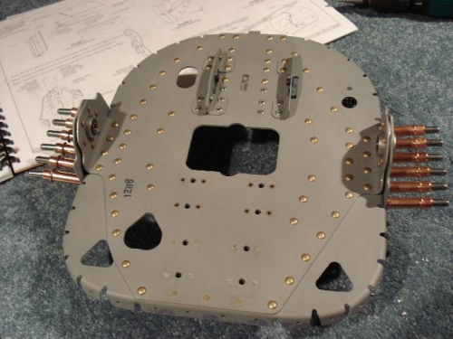

Brief Description:  Completed aft bulkhead assembly.
Finished prepping all parts for the F1211 Bulkhead Assembly. Primed all the parts, and while they were drying went ahead and fabbed and prepped more small parts. Assembled all the parts comprising the aft bulkhead assembly. All went well except I'm not happy with the way the pulled nutplate rivets seated. There's only eight of them so I think I will drill them out and replace them. I put a message out on the forum to see if others had this problem. It could be avoided with a small change in the instructions.
Hard to believe it took me the better part of the day to complete this one part - but it is a very important part where all the tail surfaces attach, and I wanted to take my time and do a quality job.

Aft Bulkhead - Aft Side
Aft Bulkhead - Forward Side
