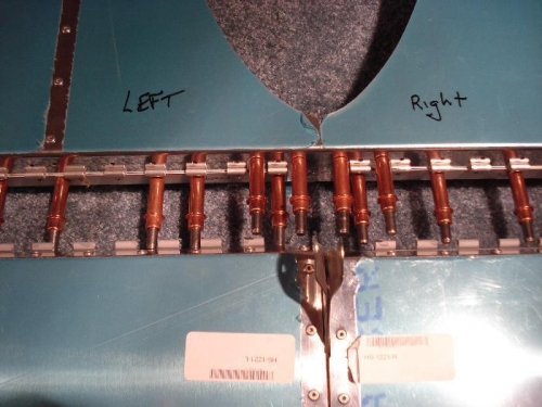

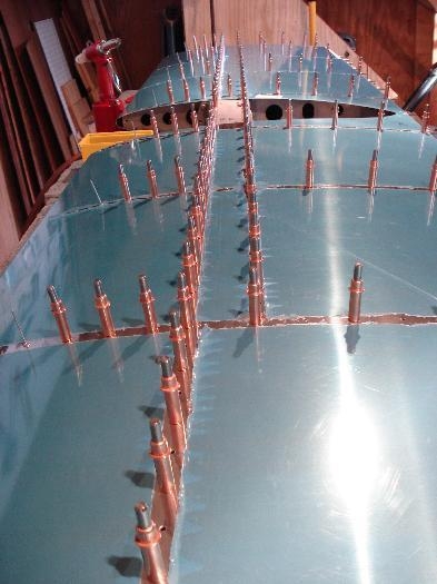

Installed left & right HS skins, clecoed, checked fit, riveted top and bottom. Man, that's a lot of rivets. Thank God for the pneumatic puller! Clecoed hinges to back of HS, checked alognment with trim tab hinges before riveting. Looks good. Riveted hinges, aft flanges, splice plate, and the short aft ribs. Clecoed aft skins in place ready to match drill and rivet. Horizontal stabilator almost done! Section 10 tail cone next. Emailed Van's to get in line for wing kit. Wait time has increased to 6-8 weeks. Guess I waited too long. There's going to be a break in the action after I finish the tail kit.

Nearly finished stabilator & tabs
Checking hinge fit before rivets
