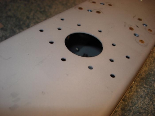

1. On page 09-04 I missed Step 8 where the counterbalance brackets get riveted into the forward and aft spars. Dumb mistake. Now the spar box is all closed up and I will either have to drill out a bunch of rivets and take it apart again, or get permission from Van's to use blind (pulled) rivets in place of the solid AN470AD4-5 rivets called for.

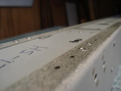

2. Back on Page 09-02 Figure1 calls for countersinking several holes for CS4-4 rivets. The instructions did not say anything about using the 120 degree countersink tool rather than the normal 100 degree tool. Being a first-time builder I did not realize that the CS4's have the 120 degree head, so I did not change the tool. Then on Page 09-03 you are told to rivet the parts together. After riveting I noticed the supposedly flush CS4's are not really flush. This may be due to the wrong countersink angle, or maybe I just didn't get the holes deep enough. I am afraid those slightly raised heads will cause a bump in the skins when they are attached. I think those rivets need to be drilled out and the holes countersunk a bit more with the corrrect 120 degree tool. Unfortunately I don't have enough CS4-4's left so I will have to get more.

Hmmm - Something missing here?
Flush rivets not flush
