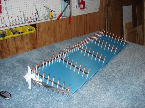

Used common bolts to temporarily mount lower VS hinge bracket per suggestion from VAF. Connected rudder spar to VS spar and noted spacing as instructed. Cleaned and primed rudder spar and then assembled full rudder skeleton. Removed vinyl and deburred all holes and edges of rudder skin. Clecoed into place on skeleton. Set aside to rivet next time. Pulled out parts for Anti Servo Tab (AST), separated control horns, and clecoed parts together to get a feel for assembly.

Rudder ready for rivets
