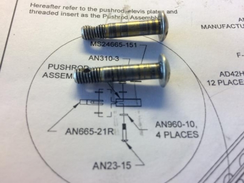

Corrected excess play in AST linkage.
Noticed excess play in AST pusrod assemmbly. Disassembled and found AN23-15 screws worn enough to cause play. Replaced with new screws and problem solved.
Worn screws
