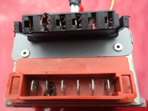

Ducati reulator/rectifier failure.
After exhibiting signs of a slowly dying alternator output for a few flights, the regulator quit entirely. Dissassembly revealed the melted contacts as pictured. Ordered new unit.
