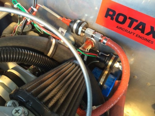

Replace fuel pressure sensor.
Ordered and installed Kavlico fuel pressure sensor to replace original. New unit now being shipped by Rotax with new engines. Tested with electric pump and ran up. Good normal indications now recireved.
Kavlico fuel pressure sensor.
