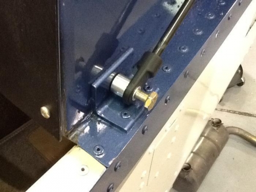

New bushings for canopy lift struts came last nght, and the springs for the muffler were waiting for me at the FBO. Removed the avionics bay cover and the struts, one at a time. Used the drill press with the step drill to enlarge the holes in the struts. Inserted the new bushings, lubed, and reassembled. Very solid.

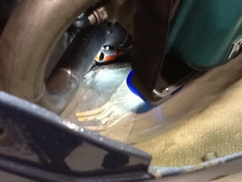

Removed the muffler and all four pipes. Cleaned all the joints and used the anti-seize paste liberally. Reassembled with nuts just snugged. Moved the muffler around to get it properly centered and torqued down the nuts.
Now for the interesting part. Most of the springs appeared to have very little tension on them, and it didn't take much force to pull the muff outward to loosen the joints. Didn't look right to me. Checked all the springs, and there was not even enough tension on most of them to create a gap between the coils big enough to insert a piece of paper into. VERY CAREFULLY (envisioning ordering new pipes) bent most of the tabs using a big screwdriver as a lever. Adjusted until all springs had enough tension to pass the paper test.
Musing about why my springs were so loose. Did I get a muffler that was welded up wrong? Couldn't be bad springs because new ones were the same as old. At any rate, I think my problem is solved. Time will tell.
New bushing going in.
New springs installed.
Critical spring clearance to cowl..
