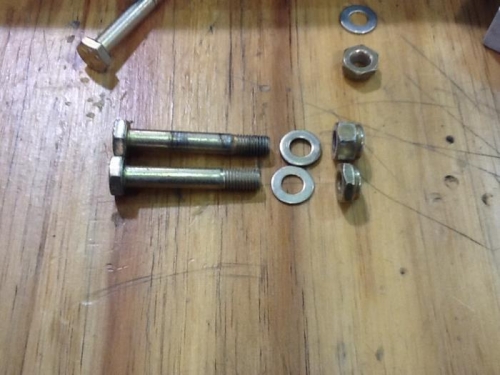

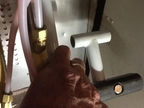

Noticed little dimples on the firewall, both sides. Determiined that the nuts on the bolts that hold the brake pedals on were contacting the firewall at full deflection. At first thought I would have to shorten the rudder cables by making new links. Instead provided more clearance by changing out the bolts from a -15 to a -14 and using thinner nuts and washers.

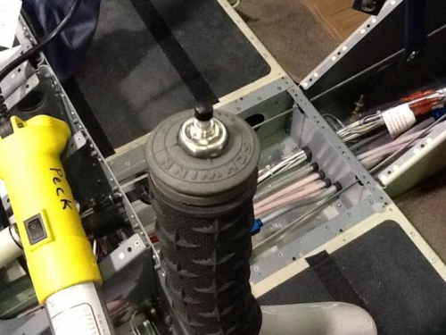

New PTT, installed yesterday.
Rudder bolt dimples.
Old and new hardware.
