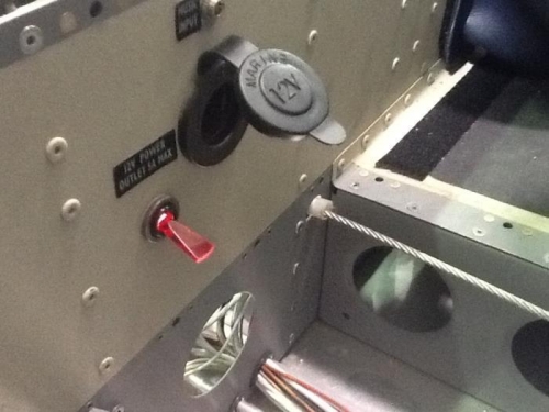

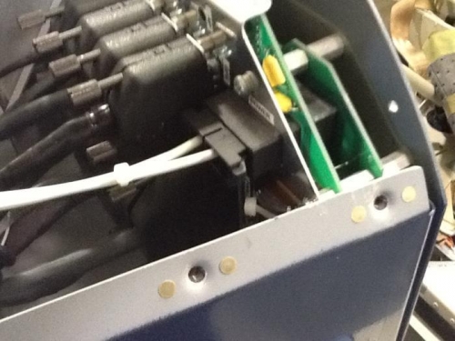

Finally got an almost full day to work on the RV. Finished the wing connector improvement kit, fuselage side. Tested with meter to verify correct wiring.
Installed the main power plug that I ordered and recieved some months ago, to replace the damaged original. (One terminal would not lock in.)
Installed an aux fuel pump switch near the fuel shutoff valve. Turning off the pump should solve the problem of incorrect (high) indicated fuel flow at high altitude.
Removed original PTT switches that have become unreliable. Next will install the replacements.
Wing connector improvement, fuselage, completed.

Fuel pump switch installed.
