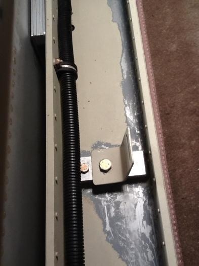

Began preparing for Service Bulletin 12-09-26. Removed the black conduit from the fuselage channel and replaced with small spiral wrap. I'll secure that to the channel wall later. Now I have visual and wrench access to the landing gear bolts. Began cleanup of softened paint where the Decalin spilled last summer.
Old conduit blocking gear bolts.
Spiral wrap instead.
