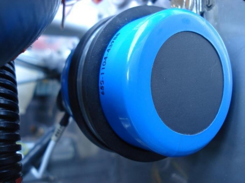

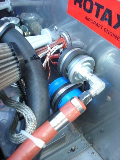

Mounted a second 22,000 mfd capacitor forward of the firewall, to try and quell the alternator noise in the headset circuit. Had some problems with bad connections because I broke the locking tabs off the connection terminals. Ordered new terminals from Van's. Temporary fix works, and noise is reduced, but not completely gone. In order to use the same mounting bolt as the fuel pressure sensor I rotated that sensor up.
Capacitor mounted below fuel sensor.
Capacitor up close.
Capacitor up close.
