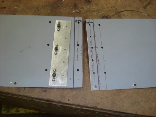

Made access panel mods.

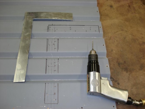

Worked in Kurt's room on the mods to allow future access to the tail cone and flaperon control areas. Measured, did layouts for rivets and screws, drilled holes and installed nutplates. Made the cuts last. Deburred and primed.
Laying out access panel cut.
