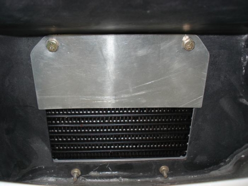

Brief Description:  Made cooling baffles.

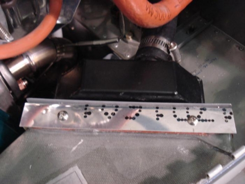

Fabricated baffles to cover approximately 1/2 of the surface area of the oil cooler and the coolant radiator. The radiator baffle slides between the rubber seals and the face of the radiator, and extends down just far enough to cover the area where the air is dumped out, rather than being forced through the heater holes in the firewall. The oil cooler baffle covers 1/2 the total frontal surface area. I'll see how this works on these winter temperatures.

Oil cooler baffle.
Oil cooler baffle.
Radiator baffle.
Radiator baffle.
