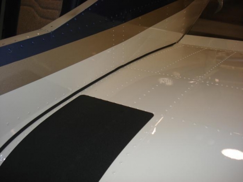

Installed the wing access covers that I painted over the weekend. Not a perfect color match, but close enough until Rob and I get a chance to redo. Installed the wing root seal foam strip to the lines I scribed on the fuselage last week.

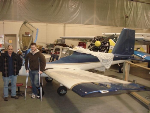

Bob Sob came by to help install the wings he helped rivet together a year and a half ago in the workshop at the lake. We inserted both wings but could not get the pins in – even the tapered pin Bill and I made last Friday. Called upon Bill once again and he put the tapered pin back in the lathe and turned down the tapered end a bit more. After that we were able to get the tapered pin in one side, then the real pin in the other, then the real pin to replace the tool. Only required some light tapping with a plastic hammer.
Tested the lights – left wing was dead. Oh well, off with the left wing again. Just a quick fix needed to spring out one of the little contacts. Wings back on the second time – went easier – probably the foam is already conforming to the wing skins.

Wings on! Pete and Micah.
Wing walk and root seal.
