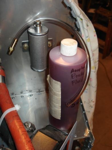

Brief Description:  Bled brakes again, worked on PAP tasks.
Went to Post Net for updated Dynon manual, stopped at FBO to pick up quart of brake fluid.

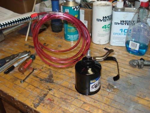

Worked on brakes again. Thought I had all the air out several times - but didn't. Finally got it out by loosening the connectors on the bottom of the master cylinders and pumping the air out there.

Brake bleed invention.
Reservoir overflow equipment.
