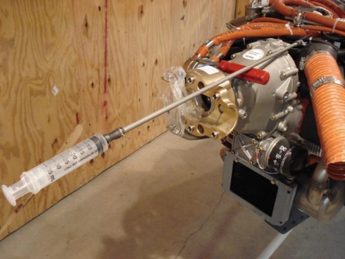

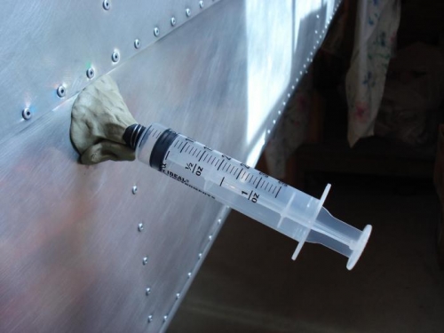

Hooked up the syringe and ran the required tests on the pitot and static systems. Had to tighten up both connections on the back of the Dynon in order to get acceptable lapse rates. The plumber's putty worked great, first try.
Ran Dynon procedure to configure the autopilot.
Pitot check.
Pitot check.
Static check - plumber's putty..

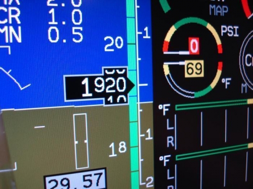

Altitude slowly dropping.
