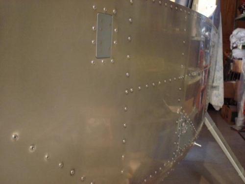

Brief Description:  Roughed the fuselage top and sides.
CJ and I moved the wings and parts out to the garage, and the fuselage back into the shop. I ScotchBrited the top and sides of the fuselage.

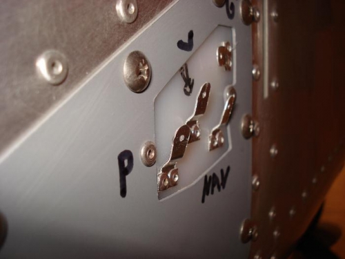

Tested the nav light sircuit by measuring the voltage at both wing root connection panels. Voltage present on both sides. Since the lights worked on both sides when directly connected to a battery, it seems that the problem probably was bad contacts at the connector panels. The contact prongs did seem to be bent in a bit, so I bent them out. See photos.

Dull fuselage.
Dull fuselage.
Right wing connections.
Left wing connections.
