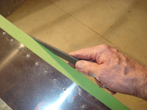

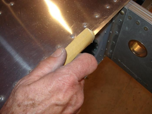

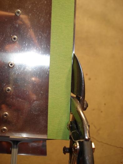

Sanded the patch to the ding repair in the right wing. Reworked the landing light lens mount. Trimmed the right wing to the 1/8" mark, using shears, then flat file, then sandpaper and ScotchBrite. Removed nav/strobe light and stored. Cleaned and scuffed entire top of right wing.

Snipping.
Snipping.
Filing.
Filing.
Sanding.
Sanding.
