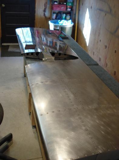

Removed blue plastic, cleaned, and ScotchBrited stabilator and trim tabs. Stored all smaller aluminum parts that have been roughed up into garage.

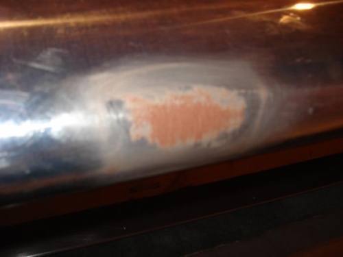

Went inside the shop to warm up (why didn't I do this in the summer?) and cleaned and roughed up the flaperons. Then got CJ back up to help remove the wings and move the right wing into the shop. Roughed up the ding from the flying unguided missile (See entry of 5/2/2009) and filled the dent with epoxy/micro mixture. Tested the lights with a battery and all worked - so the problem is not in the wing. Removed landing light lens to remove blue masking tape. I never did like the way it fit, and I think I will rework it.

Stabilator being roughed up.

Leading edge ding repair.
