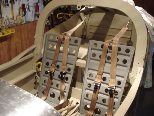

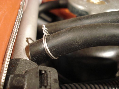

Safetied the manifold pressure hose, as recommended by other builders. Installed seat backs. Checked ability to get at gascolator screws, added washers to shorten interfering end of screw. Tightened throttle cable bolts, to complete mechanical sync. Installed inside covers other than tunnel. Installed seat belts. Installed comb on cabin heat control.
Belts installed.
Belts installed.
Manifold pressure hose safetied.
