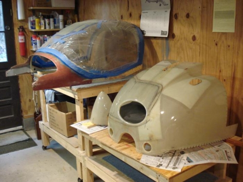

Spent a couple hours this morning coating, for the final time, all the fiberglass parts with pure epoxy. Brushed it on, squeegeed it off, and feathered with foam brush. Kept the shop warm all day and evening to promote cure.

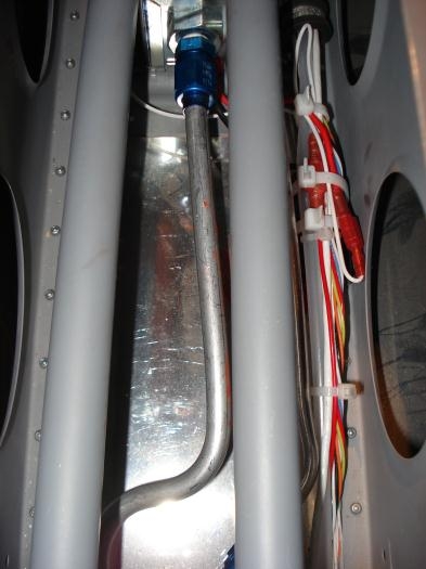

In the PM I got CJ up to the shop to help me move the fuselage back inside the shop. Spent the entire afternoon retrofitting the noise capacitor to the fuel pump. What a job, working in the confines of the cockpit, and doing the work underneath the flaperon pushrods. Would have taken 15 minutes if done earlier in build.
Some fiberglass, coated.
Noise capacitor tucked in.
