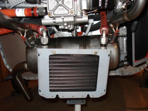

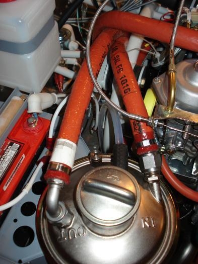

Brief Description:  Installed oil cooler and hoses.
Mixed a small batch of epoxy and painted the edges of the heat shield material. Installed oil system hoses. Figuring out the routing, and then threading the hoses through the tight quarters was a bit of a bear. Thank goodness for all the really good "pictures" on page 49-17.
The very tight clearance between the elbow and the muffler is a little worrisome - also makes getting the fitting nut started difficult.
Next I'll install the lower cowl, position the cooler, and tighten everything up.
Oil tank hoses connected.

Cooler in place -  roughly.
