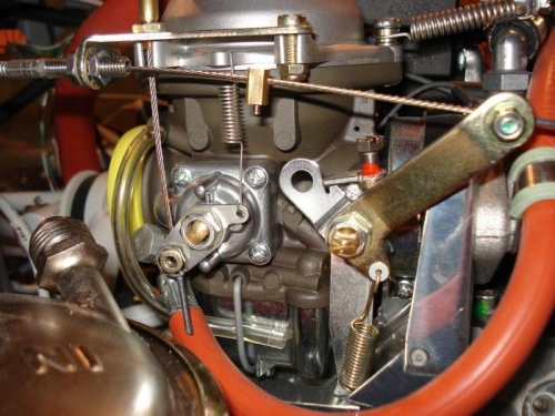

Brief Description:  Hooked up engine controls, heat proofed cowl.

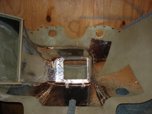

Hooked up the throttle and choke controls. Fitted and installed the heat shield material to the inside of the lower cowl. Installed the lower cowl to check positioning of the muffler.

Carburetor controls.
Lower cowl heat proofed.
