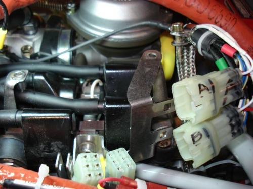

Found my way to the shop, despite long absence. Been working on the Arrow annual down at the airport. Found a few discrepancies, parts on order. Ready for Bill to start inspection.

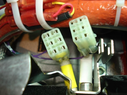

Installed the soft start wires today while Neighbor Dave was sharpening saw chains in the shop. Had to remove the electronic ignition modules in order to disconnect the connectors and insert the new pins. Instructions forgot to tell us we had to remove blank plugs that were in the holes. Figured that out and got the job done, and remounted, Loctited, and re-torqued the mounting screws.
Electronic ignition modules removed.
Soft start wires inserted (violet).
