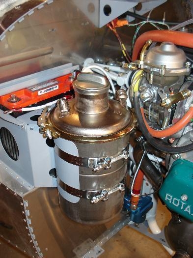

Brief Description:  Fabricated cooler box, mounted oil tank.

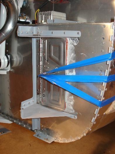

Fabricated and installed cooler box door assembly. Called Van's to order muffler spring and replacement pitot tubing. Deburred and primed all remaining aluminum parts. Installed oil tank.

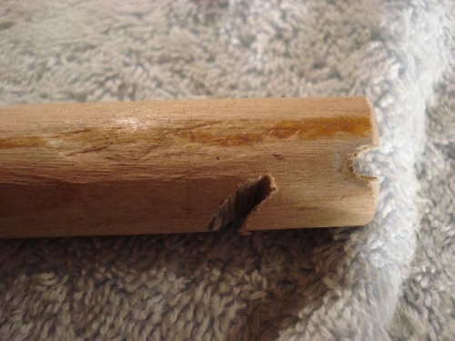

#3 picture shows my quickie tool for pushing/pulling hinge pins. Saves the fingers!
Curing RTV gasket on heat door.
Oil tank mounted.
Oil tank mounted.
Hinge pin tool.
Hinge pin tool.
