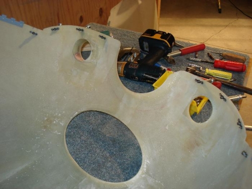

Continued with cowl mounting hardware. Installed closeout plate at the bottom.

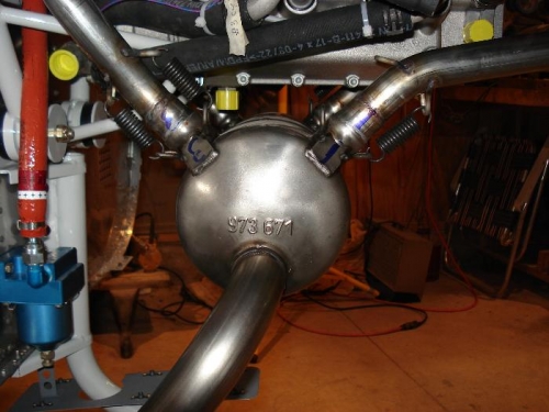

Drilled for and installed all nutplates. Installed exhaust pipes and muffler. Came up short one muffler spring. Torqued nuts to 140 in/lbs. Then turned page only to find I may have to loosen them again to adjust position. Sequence problem??? Skipped spring RTV application until I get the 8th spring.

Nutplates.
Nutplates.
Exhaust system - note missing spring.
