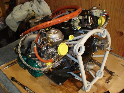

Brief Description:  Installed shroud, assembled engine topside.

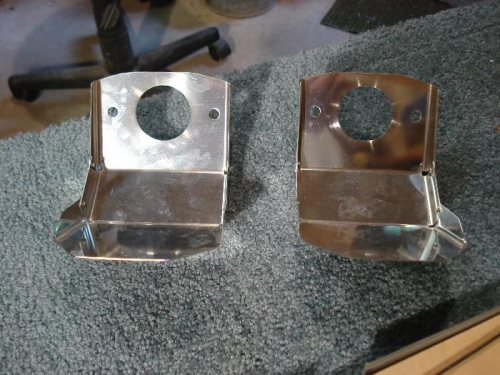

Used Bill's big torque wrench to torque the engine mount bolts. Used my little torque wrench with the new 1/4 to 3/8 adapter on all the other hex screws. Applied the red RTV and installed the cooling shroud. Put the cooling stuff back on and flipped over the intake manifolds, carbs, and ignition system and secured all. Used the green torque stuff to indicate all the bolts that I torqued. Prepped and "gooped" the carb drip pans.
Getting closer to hanging the engine. Hopefully that happens tomorrow!
Together again!
Together again!

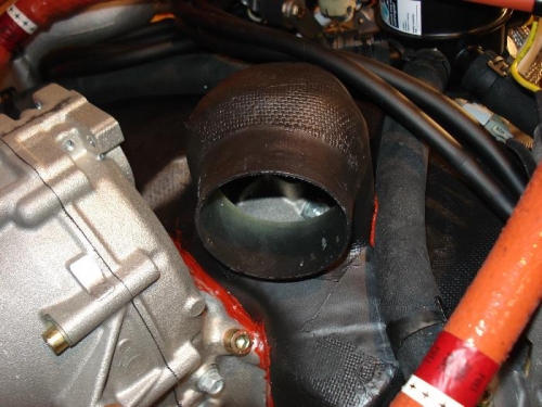

The "Black Shroud".
Drip pans.
Drip pans.
