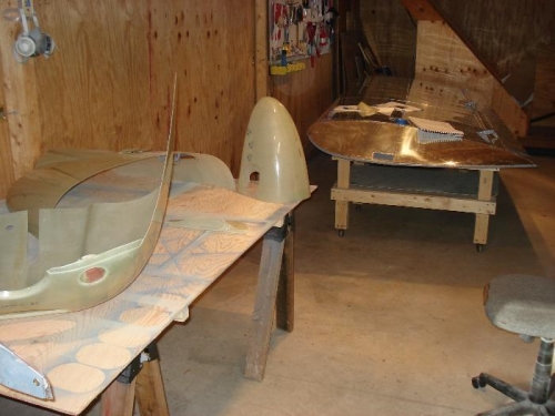

Carolyn helped me reorganize the garage and workshop to get the fuselage out into one stall of the garage, and the cowling pieces and the right wing into the shop.

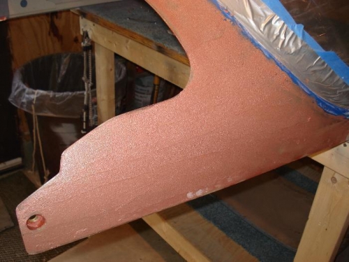

Mixed a batch of epoxy and micro-balloons and coated the canopy fairing, per Dan Horton's advice. This will provide a surface to contour for final fit.

Canopy fairing coated with micro-mix.
Workshop rearranged - again.
