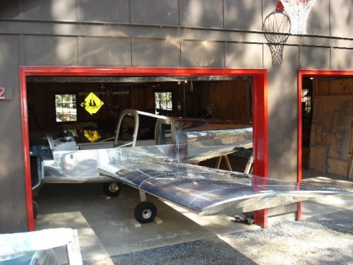

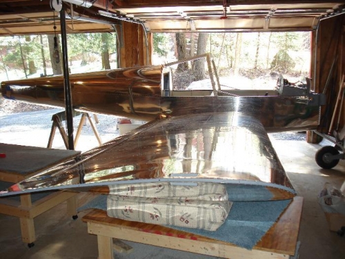

Brief Description:  Installed wings, drilled flaperon torque tubes.
Rearranged the garage again. Moved the fuselage into the garage in position to mount wings, one inside, one outside. Mounted the right wing first, then discovered the left one should have gone first. Read the instructions the next time dummy! Got both wings installed without too much trouble. Pins went in hard, but went in with some wiggling. The ends of the torque tubes matched up perfectly with the torque arm brackets,so no adjustments were necessary. Inserted the shim and drilled both holes in both sides. Removed both wings and stowed back on the racks. Moved the fuselage back into the shop.
Left wing.
Left wing.
Right wing.
Right wing.
